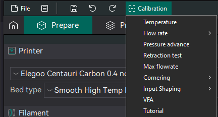

Use OrcaSlicer's Built-In Calibration
OrcaSlicer Calibration menu screenshot
OrcaSlicer includes presets for most printers, including the Prusa MK3s, Prusa XL, and BambuLabs P1S.
A full suite of calibration prints is built in to the slicer, including changing variables. This is the easiest path to a finely tuned filament profile!
Read here for detailed instructions. Generally, proceeding in the recommended order is the best plan: https://github.com/OrcaSlicer/OrcaSlicer/wiki/Calibration

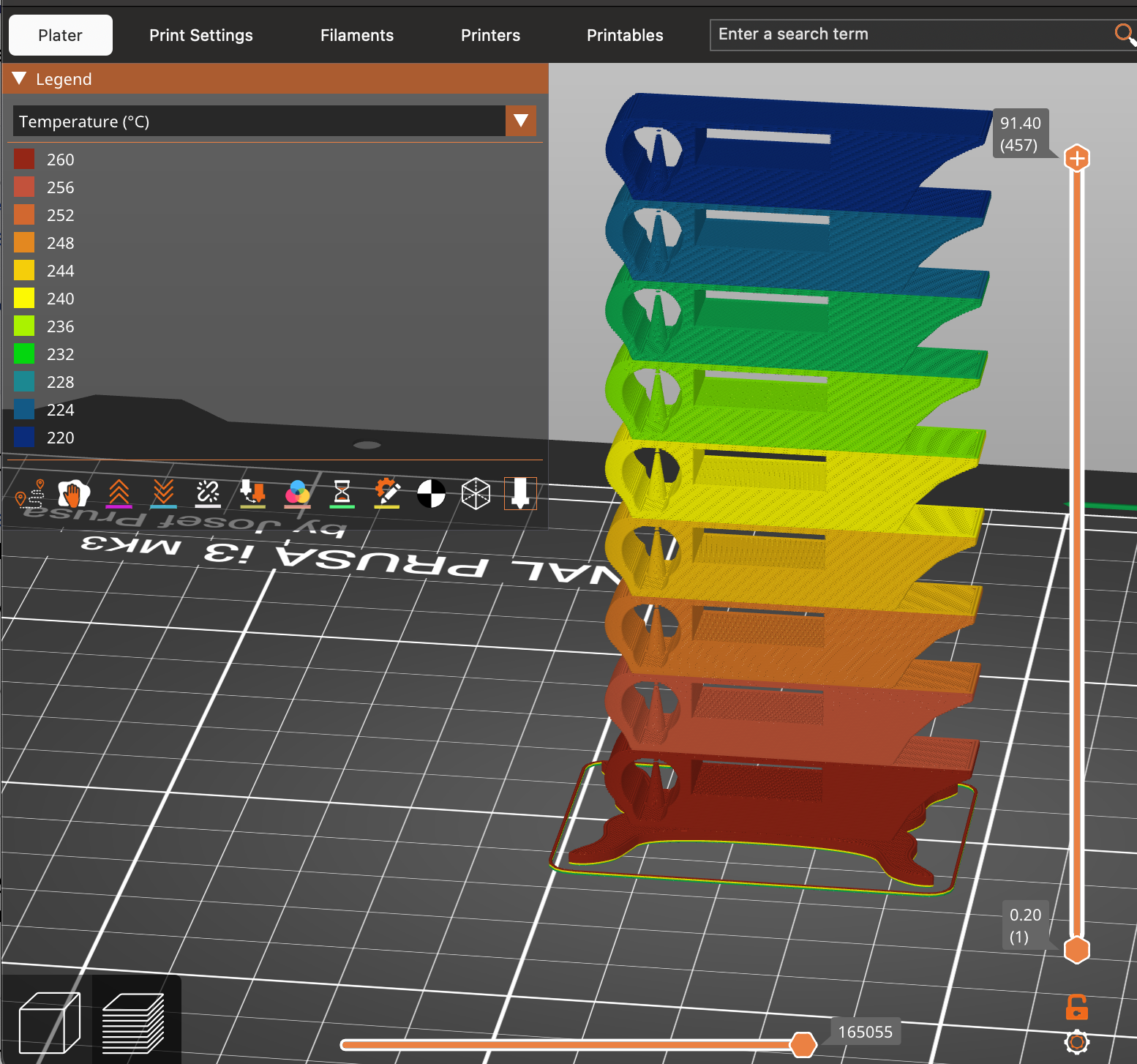

Slice the model and switch the Legend to Temperature. Make sure that each floor of your sliced mode is the right color. Note that PrusaSlicer is showing the wrong temperatures, eg. 256 instead of 255 and 224 instead of 225. I don't know why this is. The values are correct in the G-code. See the later section.

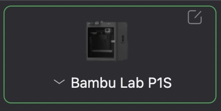

Open your STL or 3MF file BambuStudio. Set the filament to a good guess for your filament. A setting like "Generic PETG" should work if there is no manufacturer-specific preset. In the upper right, move your mouse over the printer tile and a pencil icon will appear. Click that.

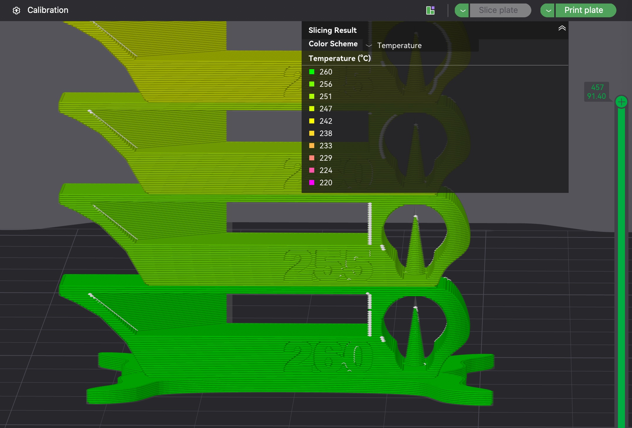

Slice the model and switch the color scheme to Temperature. Make sure that each floor of your sliced mode is the right color. Note that BambuStudio is showing the wrong temperatures, eg. 256 instead of 255 and 224 instead of 225. I don't know why this is. The values are correct in the G-code. See the next section.
