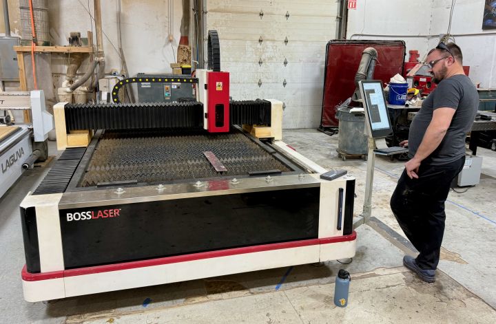

Asmbly has purchased a gently used Boss FC-6012 PRO fiber laser. We're currently getting it set up and developing training materials.
Members must complete the Fiber Laser Class before using this tool
THIS IS A CLASS 4 LASER DEVICE! EYE PROTECTION IS REQUIRED! WORK AREA PROTECTION IS REQUIRED!
This machine is equipped with a 700W IPG source and a 5'x10' sawtooth work area.
This system consists of
  • Boss FC-6012 Pro CNC chassis
  • IPG YLR-700-MM-WC fiber laser source
  • RayTools BT240S laser cutting head
  • S&A CWFL-1000BN recirculating chiller
Material Capacity
  • Mild Steel 6mm
  • Stainless Steel 3mm
  • Aluminum 2mm
