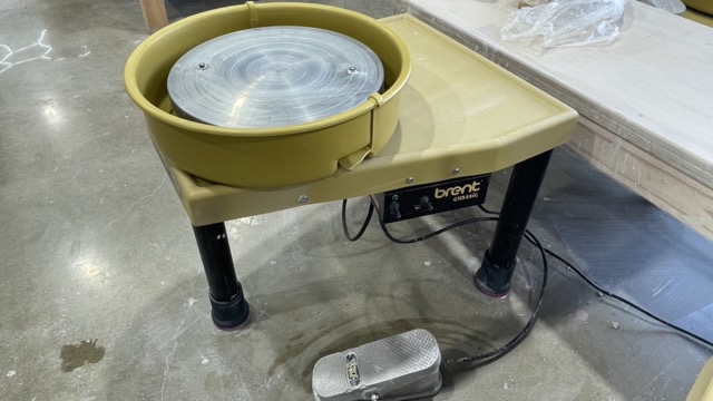

The pottery wheel is a versatile tool used to shape and form clay by rotating on a flat surface, allowing the potter to manipulate the clay into symmetrical shapes, such as bowls, plates, vases, or mugs.

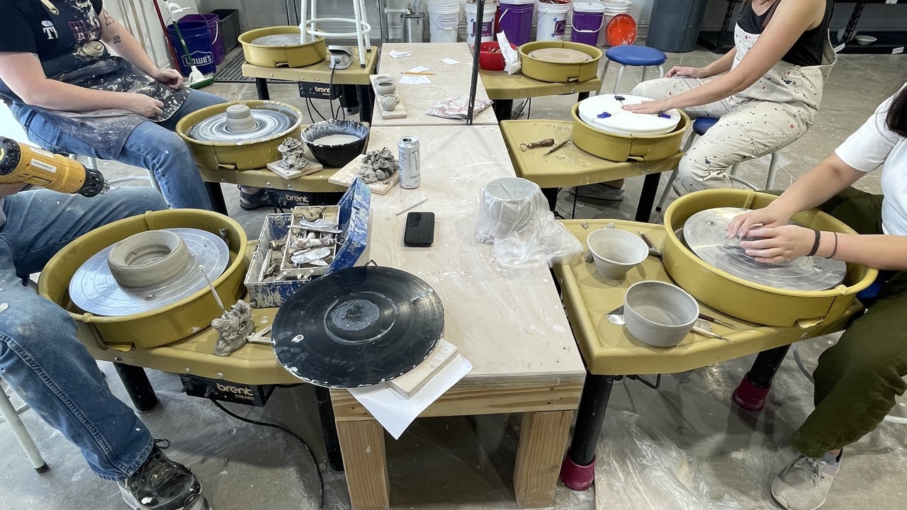

The ceramic studio has 8 pottery wheels available for use
There are eight pottery wheels available in the studio. To use a pottery wheel, please reserve one at Skedda
