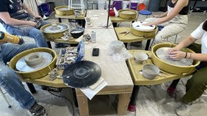

The Brent Pottery Wheel is a machine used to shape clay, and the studio has 8 near the back of the ceramics room.

The ceramic studio has 8 pottery wheels available for use
There are eight pottery wheels available in the studio. To use a pottery wheel, please reserve one at Skedda
