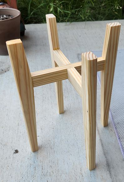

The design consists of two intersecting stretcher pieces that form a cross, with four legs attached to the ends of these stretchers.

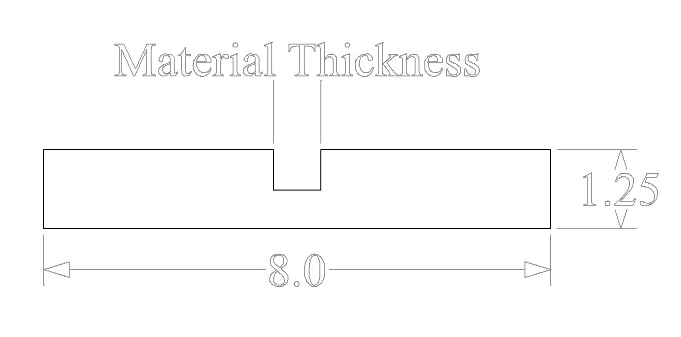

Plant stand stretcher with dimensions.

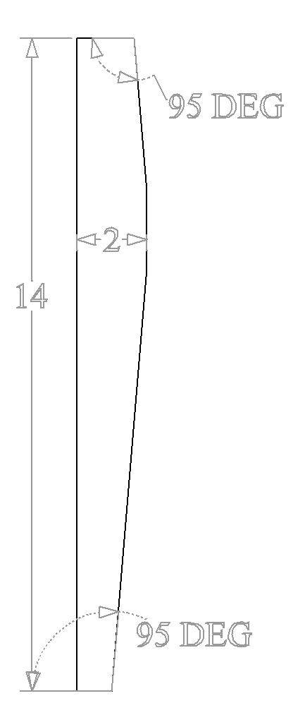

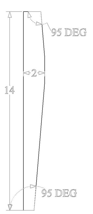

Plant stand leg with dimensions.

4. Cutting the Half-Lap Joint
The two stretcher pieces will be joined at their centers using a half-lap joint.
  1. Mark the Joint:
    1. Find the center of each stretcher piece along its length and width. Mark these centerlines.
    2. The lap joint will be as wide as the material (e.g., 2 inches if using 2-inch wide material). Mark the outlines of the joint on both pieces, centered on the length.
  2. Set Blade Height: Adjust the Table Saw blade height to exactly half the thickness of the stretcher material. For example, if the material is ¾ inch thick, set the blade height to ⅜ inch.
  3. Cut the Joint:
    1. Using your miter gauge or Table Saw Sled, make a pass on the inside edge of each marked line for the lap joint.
    2. Make successive passes between these initial cuts to remove the waste material. Alternatively, use a dado stack set to the width of the material to remove the waste in a single pass per side of the joint.
    3. The goal is to remove material from one stretcher piece on its top side, and from the other stretcher piece on its bottom side, so they interlock flush.
  4. Test Fit: The two pieces should fit together snugly, forming a flat cross. If the fit is too tight, carefully remove a small amount of additional material. If it's too loose, you may need to remake a piece or use shims if the gap is minimal.
5. Tapering the Legs (Optional)
Tapering the legs can add a more refined look. A common taper is on the two inside faces of each leg.
  1. Decide on the amount of taper (e.g., from 2 inches at the top to 1 inch or 1.5 inches at the bottom. or use a 5 degree angle recommended in the plans).
  2. Mark the taper lines on the legs.
  3. Use a taper jig on the Table Saw to safely cut the tapers. Asmbly owns a micro jig taper jig. Watch the instructional videos produced by micro jig before using.
  4. Alternatively, a Bandsaw can be used to cut tapers, followed by sanding or hand planing to smooth the cut.

8. Assembly and Gluing
  1. Dry Fit: Assemble the entire stand without glue to ensure all parts fit correctly. Now is the time to make any necessary adjustments.
  2. Attach the Legs:
    1. Attach two legs at to a stretcher. lay the entire assembly flat on the table ans use a single clap to provide light clamping pressure. Ensure each leg is square to the stretchers and that the assembly remains stable.
  3. Clean Up: Remove any glue squeeze-out immediately with a damp cloth or allow it to partially cure and then carefully pare it away with a sharp chisel or scraper.
