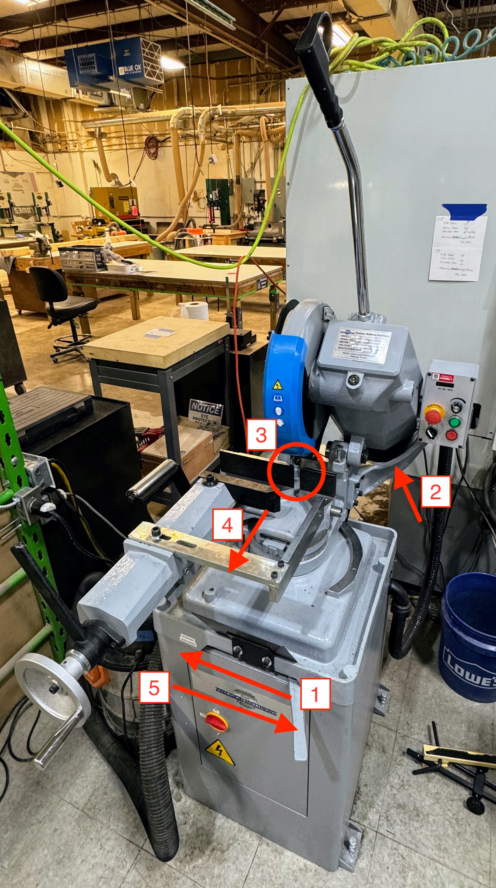

Cutting Angle Adjustment
  1. Unlock front handle by sliding to the left
  2. Rotate saw to adjust angle. The easiest spot is pushing or pulling the curved vertical arm on the right
  3. Make sure the blade clears and will not cut the work piece clamp!
  4. If it doesn't - pull/push the clamp forward/backwards until it clears
  5. Lock the front handle by sliding to the right
