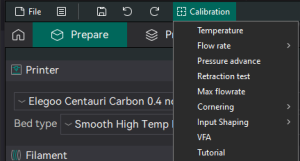

Use OrcaSlicer's Built-In Calibration
OrcaSlicer includes presets for most printers, including the Prusa MK3s, Prusa XL, and BambuLabs P1S.
A full suite of calibration prints is built in to the slicer, including changing variables. This is the easiest path to a finely tuned filament profile!
Read here for detailed instructions. Generally, proceeding in the recommended order is the best plan: https://github.com/OrcaSlicer/OrcaSlicer/wiki/Calibration

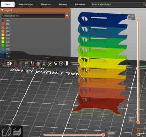

Slice the model and switch the Legend to Temperature. Make sure that each floor of your sliced mode is the right color. Note that PrusaSlicer is showing the wrong temperatures, eg. 256 instead of 255 and 224 instead of 225. I don't know why this is. The values are correct in the G-code. See the later section.

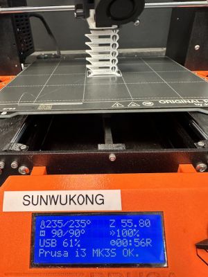

When you're sure your G-code is right, print the model. I like to check the display after the base prints, and again after the first floor to make sure the nozzle temperature is actually what it should be.
