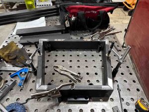

A frame made of rectangular steel tube is fixtured to the fixture table with clamps and blocks.
The fixturing table allows you to position and clamp your work securely and precisely. It is particularly good for setting up rectilinear parts so that they meet at right angles. You can lay out and clamp a complete design and tack weld it while all parts are held in place to minimize distortion.
Please do your best to not get weld spatter on the table, so that work can be laid out flat on it.

The table has 5/8" holes on 2" centers. 16mm fixtures should generally work. A limited selection of clamps, stops, and V-blocks for holding round stock is kept on hand.
