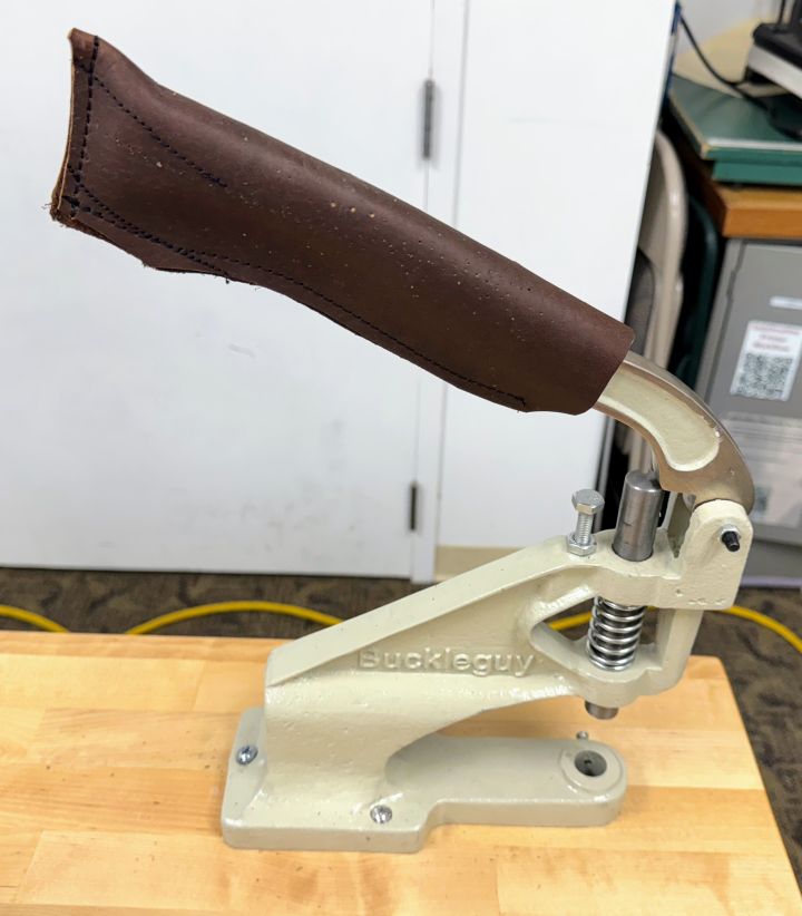

Buckleguy Hand Setter
Asmbly has a Buckleguy hand setter for various textile hardware. As of now (12/23) we have dies for 7mm rivets and a few sizes of snaps.
This press accepts "BG Standard" dies:
  • Diameter of threaded upper die: 7.8mm with a 1.411mm thread pitch
  • Diameter of anvil (not threaded): 18.9mm
  • Throat Depth (starting at middle of setter die): 4.5" (114.3 mm)
