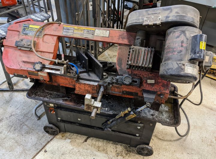

Central Machinery Horizontal Bandsaw
Central Machinery Horizontal Bandsaw, located on the north side of the metal shop, next to the cold saw.

Use Case
The bandsaw is used for general-purpose metal cutting. It is suitable for bar, tube, and plate stock, but not for sheet stock. Used properly, it produces a fairly smooth, straight cut, which may be good enough for some applications, but you should not expect perfectly square cuts, so if precision is required, consider the bandsaw as a roughing step.

Setup
  • Lift the blade to the vertical position. Turn the lowering knob to fully stopped and turn on the brake (lever is perpendicular).
  • Place your material in the vise. Note that when you loosen the vise with the crank, it often doesn't move the jaw, so, you may have to manually move the movable jaw.
  • For long material, support the end with the wooden support, or it is likely to come loose in the vise.
  • Once your material is in place, lower the blade to the diagonal position. Because you set the brake, it should remain stationary there. Release the brake and turn the lowering knob to allow the blade to get close to your material so that you can line up the cut.
  • Adjust the throat of the saw so that it is not much wider than it needs to be to clear the stock during the cut.
  • Raise the saw back above your stock, set the brake, and turn the lowering knob to fully stopped.
Cutting
  • Turn on the saw with the switch. Let the blade get up to speed. Open the coolant valve enough that there's a good flow of coolant along the blade, but not so much that there's a good flow of coolant all over the floor.
  • Release the brake, and turn the lowering knob so that it slowly lowers.
  • When the cut is finished, the machine will flip its own power switch to off.
