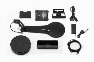

EinScan-SE 3D Scanner
The 3D Scanner can be found on the table to the right of the Filament Printer enclosure.

Plug all cables into both the scanner and the laptop.
Power On
Turn on the scanner by pressing the power button for at least 2 seconds.

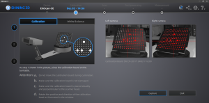

Open the EXScan software.
Calibrate
For optimal results and accuracy, calibrate the scanner before starting any scans. Follow the on-screen instructions to calibrate using the calibration plate (a square board with dots).
Optional: When scanning models with color texture, perform a white balance calibration using a white piece of paper.

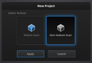

Once calibration is complete, position your model at the center of the turntable, then click on "New Project."
Select a save directory, enter a project name, and choose either "Texture Scan" or "Non-texture Scan."
