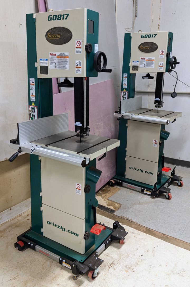

Asmbly has two Grizzly G0817 14" bandsaws for contour cutting.
The brake pedal is the off switch. Push hard.
No adjustments allowed, except for Fence & Cutting height.
These saws lack automatic dust collection. Vacuum around the saw and inside the cabinet after use.
These saws take 120" blades. We typically equip one with a 1/8" blade for fine contours and one with a 3/8" general-purpose blade.
  • No blade changes - call a steward or report via red QR code.
  • Do not adjust bearings or tension. Do not release tension.
  • If you see a problem that you think needs these adjustments, report using any red QR code.
Maximum cutting height is 14", maximum cutting width is 13½"
