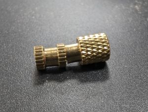

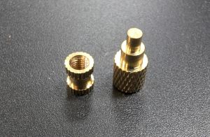

The soldering tip for the inserts screws on to the soldering iron. Using an insert of the correct size (double check with calipers!), make sure the smallest tip section can insert inside the threads, and the shoulder section contacts all around the rim. Screw the selected tip onto the iron, and screw the replaced tip down to the base for safekeeping.

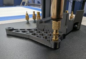

1. Using the tweezers, hold the insert up on the soldering tip for a few seconds to preheat.
Error creating thumbnail: File with dimensions greater than 12.5 MP
2. Push the press arm downward, centering the insert on the hole, and release the tweezers once in a stable position. If needed, you can place the hot insert on top of the intended hole and the additional friction will keep it approximately in place while you handle the part as a whole to align it.
3. Adjust as needed to the center of the hole, and press down steadily on the arm. It should not need significant pressure, as the heat will melt the plastic out of the way and the insert will press in slowly.
4. Stop when at or just below the surface of the part, and allow the arm to raise back up in a controlled manner.
