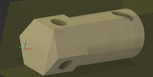

WCS
The work coordinate system X axis must be along the rotary axis center.

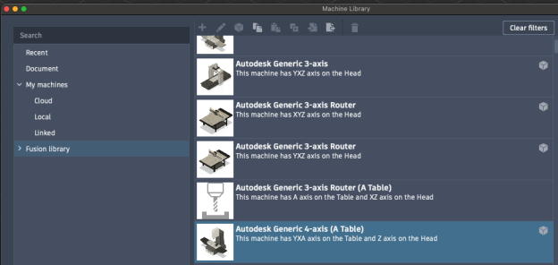

Machine Type
Pick "Autodesk Generic 4-axis (A Table)"

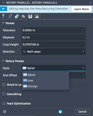

Multi-Axis Menu

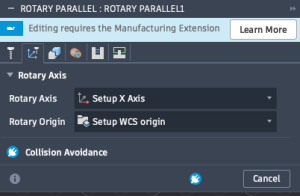

This requires the machining extension. Rotary Parallel is good for a lot of cases. It can do any kind of complex geometry. In the multi-axis tab, make sure that Rotary Axis is "Setup X axis", and Rotary Origin is "Setup WCS Origin".
In the passes tab, there are options for how the rotary passes are done:

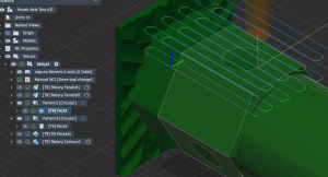

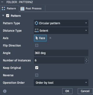

Rotary Pattern
Does not require the machining extension. This is an indexing operation, inside of which you can use 2D toolpaths. Start the pattern by selecting Pattern from the Setup menu.
Under the pattern operation you can add 2D toolpaths:

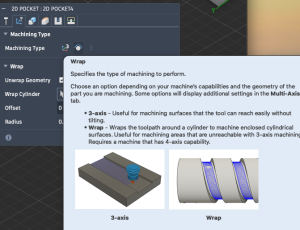

Wrapped 2D
This takes a normal 2D toolpath and wraps it around a cylinder. A limitation is the toolpath cannot go all the way around and meet where it began. It either must be a spiral or slot of some sort. Only certain 2D operations support wrap.

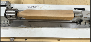

Position the Rotary along the X axis. Use the dog holes to make sure the Rotary is aligned to the X axis. Secure using screws.
Plug in the rotary into the receptacle which is on the side of the control box close to the floor.

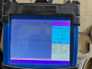

The rotary axis is referred to as either the "C" or "A" axis on the control. Use "C" on the control to move the rotary axis. To zero the rotary axis, select "ZC→0" and select "A".

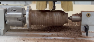

Workholding
For workholding, you can turn a tenon on your stock and grab the stock in the chuck. There are internal and external chuck jaws to handle various stock sizes. There is also a faceplate, which you can secure to your workpiece using screws. If you do this, make sure you will not machine into the area where the screws are.

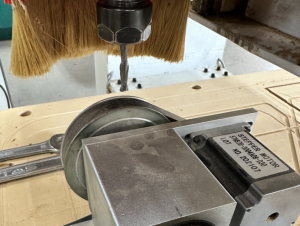

Align Y axis to the centerline on your part. Ideally use a tool bit with a point for accuracy. If not accurate, your machined diameters will be oversized.
Move to your X axis zero on your part. When selecting this, take care that the toolpath will not hit the chuck, faceplate, or center.
Press "XY→0".

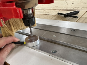

The Z zero should be set up to be the middle of the chuck. This is 65mm from the metal base of the rotary.
First, use the Z-touch to touch off the base:
Then, move the Z axis to 65mm, and zero the Z axis.

Use the C buttons to rotate the axis to your desired start point, if needed. Zero by using "ZC→0" and select the A axis.
