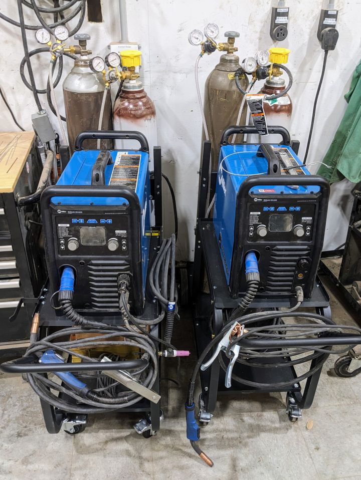

Asmbly has two Multimatic 220 multi-process welders. These have both MIG and AC/DC TIG capabilities, each of which has its own prerequisite class. One's owned by Asmbly, the other's hosted by Jon.
Members must complete the MIG Welding Class before using this tool
Members must complete the TIG Welding Class before using this tool

The Miller Multimatic 220 AC/DC is a versatile multi-process welder capable of MIG, Stick, and TIG welding, suitable for small fabrication shops, maintenance, and hobbyist applications. It supports both 120V and 240V power inputs for various work environments.
Material Capacity
  • Mild Steel 24 ga. - 3/8 in. (MIG)
  • Mild Steel 24 ga. - 1/4 in. (TIG)
  • Aluminum 24 ga. - 1/4 in. (TIG)
