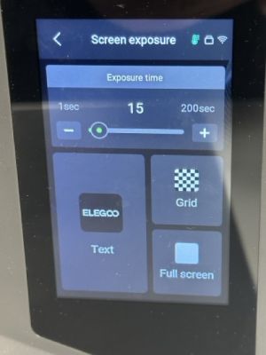

For Dione, the Saturn 4 Ultra, use the Tool > Screen Exposure screen. Use the Full Screen button.
