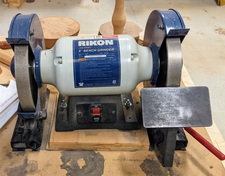

Rikon 80-805 Bench Grinder
The Rikon 80-805 is a low-speed 8" bench grinder. Asmbly's is equipped with diamond wheels for sharpening turning tools.
Guidance for Sharpening Wood Turning Tools
Members may use either wheel on their own tools. However, we request that woodturning shop area tools only be sharpened on the rightmost (fine grit) wheel, as the left is reserved for reshaping tool profiles. Below I will go through how to sharpen different woodturning tools (Pictures coming soon):
