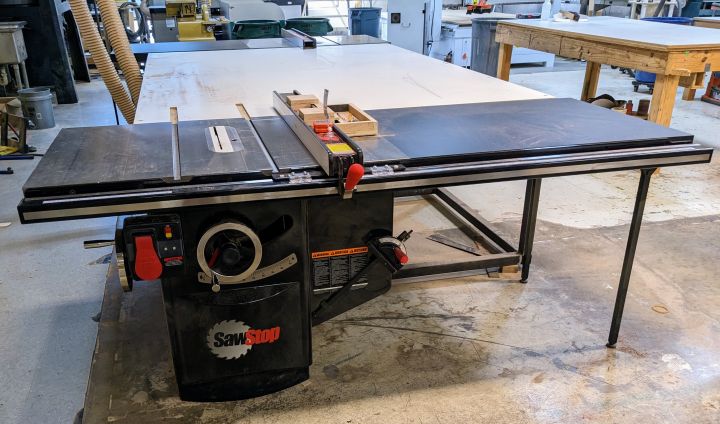

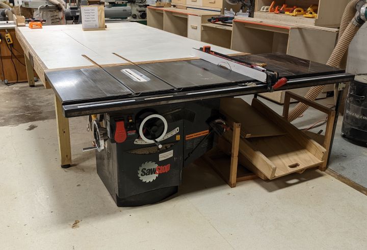

Asmbly has two SawStop 10" Industrial Cabinet Saws.
  • model ICS51230 5hp is owned by Asmbly
  • model ICS73230 7.5hp is hosted by Danny

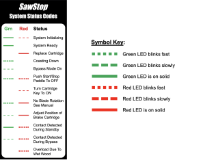

If the saw does not start when pulling the paddle, the two status lights on the control box may indicate why:
After turning the main power switch on, the status lights will blink as the saw boots up. A solid green light with no red light indicates that the saw is ready to start. The saw will refuse to start while it’s still booting, and the status lights will flash (labelled “Push Start/Stop Paddle To OFF” on the below cheat-sheet).
This cheat-sheet is from page 30 in the above-linked manual. It’s also printed on the left side of the control box near the start paddle.
The saw may also refuse to start if it detects contact with the blade when the paddle is pulled on (labelled “Contact Detected During Standby” in the cheat-sheet). Make sure nothing (including your workpiece) is contacting the blade when starting the saw.
If no status lights appear after turning the main power switch on, make sure the red-and-yellow disconnect rotary switch (left side of the cabinet) is in the on position.

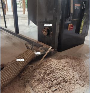

Clear Dust Collection Hoses
Small offcuts can frequently fall into the table saw and clog the dust collection hoses. The hoses should be visually inspected for blockages daily or whenever excessive sawdust is observed during operation. When the dust collection system is working correctly, very little sawdust should accumulate around the table saw.
Procedure
  1. Find the dust collection port behind the saw, low to the ground.
    1. Watch you head!
  2. Visually inspect the hose for a clog. The hose is slightly transparent for easy inspection. A clogged hose is heaver than you might expect. Lift the hose off the ground.
  3. If clogged, remove the hose clamp and hose from the saw.
  4. Shake the hose and gently hit the sides of the hose to remove stuck debris.
  5. If the dust collection port is also clogged, insert a shop vac into the port until the port is clear of debris.
  6. Reattach the hose.
