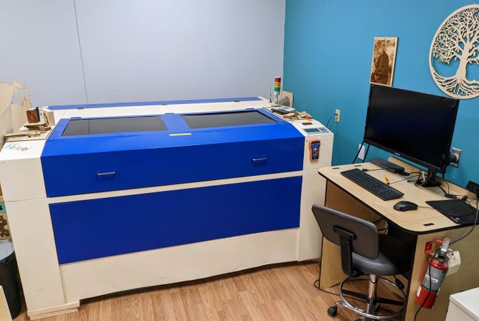

Tarkin is the new large-format laser cutter in the space, currently the most capable of our lasers for 2-d operations. It's a hot-rod custom-built laser cutter based on an RF CO2 10.6um laser and the latest in C-rail linear rails and a closed-loop servo-stepper motion system with a Ruida RDC6445G controller running Lightburn software. It features 225W of power on a 1.6M x 1.0 M (63"x39") cutting bed, powered Z, 16MP alignment camera, and air assist.
It's quite large and capable -- we don't think there's anything like it in central Texas.

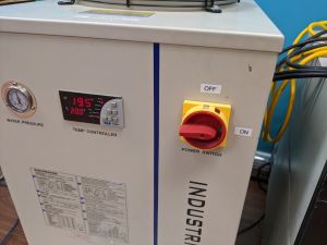

3. Chiller switch
Starts chiller, required for all work. The machine will refuse to run and give a "WATER PROT" error if the chiller is not pumping.

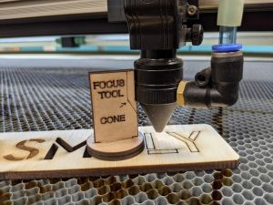

Focusing
Focusing is currently done manually (this may change). For reference, the focal point is 6mm from the tip of the cone.
Although the head, like most designs, has an adjustable tube, we do not operate by adjusting the tube. Please ensure to tube is all the way up before continuing.
Focus tool
Place your material on the machine bed
jog the head above the material
Place focus tool on top of material as shown
Use the Z+/Z- keys to raise and lower the bed until the focus tool corner, as shown on the tool, aligns where the corner of the conical part of the cone turns into the cylindrical part.
Once you reach the proper height, nothing else needs to be pressed and you can continue to use the machine. The control panel will read out around "Z 3000mm". This number is not important. In cases where you need to deal with thick material, you may raise the bed from this point by as much as -5mm. If so, this readout can be used to measure simply by relative values. e.g. "Z 3002.7" after using focus tool. To achieve focus -2, press Z UP until the display reads "Z 3000.7"
Conversely, rastering time can be greatly reduced by lowering the bed after using the focus tool to increase the spot size and increasing the line interval by the corresponding amount. Lowering by 7mm corresponds to roughly 0.5mm line interval and 14mm is 1mm line interval.

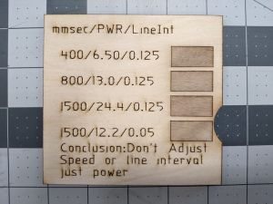

In most cases we will not use 100% power. This is so much burn it could go all the way through the stock.
Line interval is equally important with power in determining burn depth, assuming your line interval is below 0.175mm thus not producing gaps between lines. If we halve the interval- thus doubling the vertical number of burn lines per mm- the fill will be twice as deep for the same speed and power setting. Also takes exactly twice as long, thus there's little reason to do this instead of raising the power which takes no extra runtime.
So, usually we're at 800 mm/sec or 1500 mm/sec, 0.125 mm line interval, and exclusively using Power to control burn depth.
These all produce similar burns, but the top and bottom settings attempts waste runtime
These all look basically the same and have similar depth. 400mm/sec takes twice as long to cover the square over 800. These speed changes have no benefit.
Changing line interval from 0.125mm to 0.05mm takes 3x longer, but gives the same look. The fine-line-interval approach generally has no benefit below 0.125mm.
Why is 800 and 1500 being lumped together? Well, 1500mm/sec is a big timesaver on WIDE rasters, like >500mm. But the high speed requires a larger fixed clearance to the end of the rails (about 100mm "extend space") and also a larger fixed waste-of-time spend braking and reversing each line, regardless of the width of that line. With a 50mm wide raster, 1500mm/sec will not be any faster than 800mm/sec anyways, as it wastes so much time per line in extend space space and gets minimal benefit in moving twice as fast over the 50mm it actually burns.
Simple Bottom Line: 800mm/sec 0.125mm line interval for smaller Fills (or grayscale), and adjust ONLY the power for your depth of burn. 1500 mm/sec for larger Fills. Adjusting for lower speeds or smaller line intervals will not produce any different look than you could get with the right power level, they just waste time. The Line Interval can be increased to about 0.175mm, but this can produce a slightly wavy bottom and a higher number will leave visible rows as there is no overlap at all between lines.

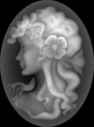

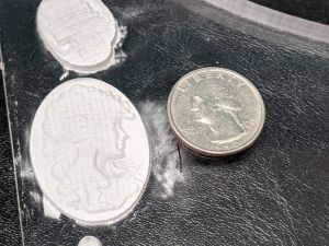

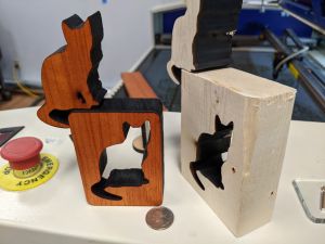

GRAYSCALE 3D RELIEFS ("depth map")
Same mode, but different goal. Laser power is high enough to carve into the material. We are not trying to produce varying shades, but varying depth. Works very well with wood and acrylic. Homogenous materials like acrylic have a very constant power-to-depth ratio. Wood, however, has bands of hard and soft grain. The higher density of the hard grain bands leave a shadow that will not be cut as deep. This is part of the character of 3D cutting wood. This also affects all FILL.
A bitmap used for this purpose is called a "depth map", but it is essentially a grayscale image with depth represented as darker pixels. But this is still fundamentally different from a picture- if a photograph of a light-skinned person were cut as a depth map, it would appear grossly distorted- the whites of the eyes are highest, the hair would be cut deep, and pupils cut deepest. [TBD: example of distorted use of 2D image]
Depth Map
Cut depth map, negative image cut from rear in acrylic
If you want to avoid creating obvious unburned areas where the shading is very light, set MIN POWER parameter >0%. While in the raster area, this rescales the laser output. Black is MAX POWER %, white is MIN POWER %. In acrylic we often allow the lightest shading to remain untouched clear acrylic for contrast.
3D may utilize smaller line intervals effectively, it will just burn deeper as lines overlap. However, in general increasing the power may be more practical.
STL model files can be turned into depth maps via https://www.meshlab.net/
Note that STL files generally need to be designed as 3D reliefs to produce good results. Reliefs are an artistic style that trick your perception into seeing a much deeper scene than the actual material. Simply flattening a 3D scene by 99% may not yield usable reliefs.
3D reliefs have difficulty scaling. 15mm acrylic cut a max depth of 8mm might produce a great quality image when rendered in a 100mm x 100mm frame. However, when increased to 200mm x 200mm, the same 15mm acrylic cannot be burned twice as deep. If burned to the same depth, the image will be relatively flat in the Z dimension. In order to maintain the original scale, the acrylic stock would need to be 30mm thick!
Reliefs in clear acrylic look MUCH better when mirrored, the shading changed to "negative image", and cut from the BACK side. When edge lit, the look is fantastic!

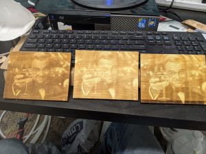

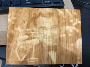

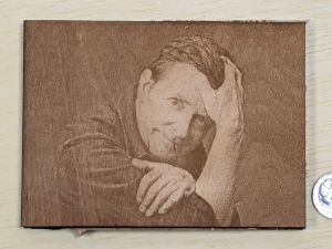

DITHER/HALFTONING 2D
Most common choice for photographic work. The basic scheme of dithering is we have the original unburned surface and burned "brown" areas and nothing in between. The appearance of "shading" is created by a ratio of these, not by turning the laser intensity up and down.
The beam is often turned down quite a bit- 8% on wood is a good starting point.
DiCaprio in halftoning, line interval 0.150mm
Closeup of DiCaprio's eye in Halftoning, line interval 0.150mm

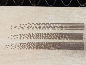

Proper Line Interval in Image Dithering/Halftoning
Dithering/halftoning MUST use correct Line Interval that matches the beam width.
The first gradient shown has line interval set 33% too high. Visible white lines separate the dithering pixels regardless of the image's grayscale value at that point. At a distance where dithering pixels are not apparent, this reduces the deepest color change that can be achieved, and also the level of detail (resolution) is decreased.
The lower gradient is too low, 67% of what it should be, and this has mostly broken the dithering scheme. The rows are overlapping, resulting in completely burned-out areas past around 50% gray; there is little midrange.
The middle is just right! Raster lines abut but do not overlap.
The width of the burn mark at good focus is approximately 0.175mm-0.100mm, it narrows with higher speed (less burn) so recheck the line interval after changing power.

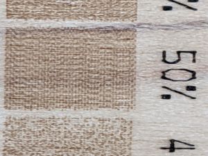

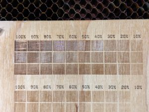

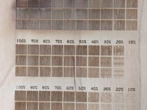

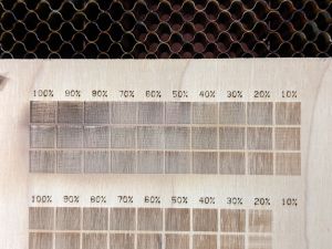

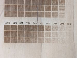

If instead you want to develop your own settings, possibly for a focus+ situation, here is the method:
Load Lightburn project "tarkin_raster_calibration.lb2", and try with the enclosed power settings on a test piece of your material. This essential testing step for determining speed, power and line interval burn settings that must operate in GRAYSCALE MODE, EVEN IF YOU ULTIMATELY INTEND TO DITHER. At best focus (not focus+), line interval is known to be roughly 0.15mm, so we have a 0.1mm, 0.15mm, and 0.20mm line interval rows here to verify.
We increase the power in 10 steps from left to right columns, and show the color change as shading increases the beam to the full power setting. Although done in grayscale, this calibration is necessary for dithering modes as well.
This is a shot in the dark with 1500 mm/s and 40% power. The % in font represents the fractions of the 40% power. The rows represent 0.10mm, 0.15mm, and 0.20mm line intervals. At a distance, the color seems similar, but the blasting of soot at the higher powers is a bad sign. After a cleaning of loose, dusty soot particles, we have this:
Overburn apparent on cleaning
Overburn apparent on cleaning. The top ply stopped getting darker after the first couple of panels. This is OVERSHOOTING the power, removing the surface ply entirely and exposing the glue and inner layers which are somewhat lighter and not even brown. The reddish look is the glue layer. Let's back off from the 40% power down to 1/4 of that, changing 10% power=full scale.
The line interval is appearing to favor the 0.15mm middle row, but let's look closer.
zeroing the scale at 10% power
Now the scale has 10% power for the 100% of grayscale, total black square of the original graphic. But, wood being wood, our dynamic range is poor. The 80% of that shows approx the point of max color change, a net of 8% power. At this point, the strength of the beam produces a beam width that hits the sweet spot of no gaps but minimal overlap at 0.15mm. That should be our line interval for this net 8% power, let's verify in the next step.
Now that we know 8% power 0.15mm line interval produces the best color change, let's change this entire graphic from grayscale to stucki dithering, which will decide when to fire or not based on shade, but when it fires it will always be at 8% power 0.15mm

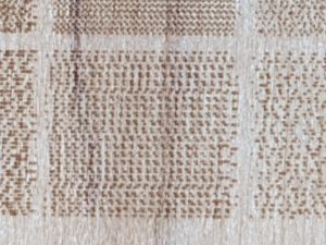

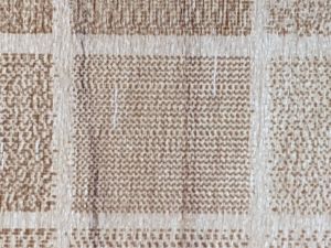

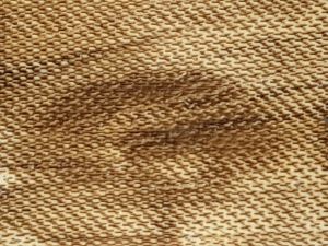

Dithering at correct power, but with different line intervals

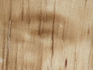

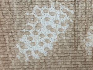

Let's take a closer look at the raster's lines
0.1mm, too close
0.1mm line interval, these rows are too close and overlapping the dither patterns, breaking the effect. Everything starts to look a similar shade of brown as the rows of pixels overlap, more so at the deeper grays. So the dynamic range is all in the lower % and then turns all similar-looking brown after 50% gray.
0.15mm line interval at 8% power= net 5%. The columns are just short of overlap. This is a correct raster target!
0.2mm line interval, gaps appear between rows
On the other hand, 0.2mm line interval is showing gaps between rows. The line interval is too wide.
We have successfully determined our ideal numbers a dithering raster for standard focus- 1500mm/s, 8% power, 0.15mm line interval.

As noted, 1500mm/sec 8% power 0.15mm is a common spot for burning wood. That's max speed of the machine axis. We can't change the line interval without breaking dithering. 750mm/sec 4% power would yield approximately the same burn, but pointless as it is twice the machine time.
Rather, we can lower the Z to increase the focal distance, "focus+". This increases the burn width, and we will increase line interval to match that The cap is focus+15mm produces approximately a 1mm line, and is an approximate limit of benefit because power increases to about 100% to maintain the burn intensity over the wider line. Net benefit is the job runs 7x faster. Anything further would require slowing the raster to keep the same burn intensity, no longer speeding up the process thus defeating the point.
This decreases the vertical lines of resolution per mm, but its greatest value is in huge poster-scale rasters that have large numbers of vertical lines in the entire image due to the large scale, so detail can still be represented.
Focus+ works only on Tarkin, since it has advanced, fully adjusted beam collimation that produces a totally consistent shaped beam width anywhere on the bed. It will yield distorted images on most other machines as the line width will vary across the bed.
RASTER EXTEND SPACE: what's that?
All rastering is done when the laser head is at the specified constant velocity, for image consistency. This requires "extend space" on the margins of the raster for the head to brake to a stop and accelerate back, and the amount of extend space required scales up with raster speed. For this reason, rastering cannot be done at the far left/right margins of the machine bed. If your job requires extend space that exceeds the machine bed, it will abort with a "NOT ENOUGH EXTEND SPACE" error when you press Play. Move the raster work from the edge or reduce raster speed to shrink the extend space needed.
Don't put your work up against the left or right side of the honeycomb as an alignment ruler. That will likely trip this error.
Extend space creates a slightly complicated relationship with raster speed and ultimate job time. 300mm/sec is very little extend space, 1-1000mm/sec requires 75mm on either side. For example, with a raster image only 25mm wide, running 1000mm/sec will actually take longer than 300mm/sec as it must use a wide margin of extend space to brake and reverse up to that high speed that is only used for 25mm. However, for a 1 meter wide raster, 1000mm would be substantially faster. The time wasted braking and reversing through the extend space on each pass is a fixed time per line, but the bulk of the time per line is spent on the 1 meter raster job which goes twice as fast.]
1000mm/sec is best for wide rasters (>400mm as a wild guess)
Inside Lightburn, the Preview window will show you the effects of raster speed on runtime for your specific job.
The FRAME button does NOT show the bounds of Extend Space. Take care when placing holddown weights (which, unlike the magnetic clamps, require more clearance than available so the head will strike it) to the left or right of a raster. There is no easy way to guess how much Extend Space will be used. The amount of Extend Space also depends on the machine parameters, which may be tweaked from time to time. In general these future improvements should reduce, not increase, the amount of Extend Space needed
Lightburn Preview will NOT warn you if your job's Extend Space would run into the limits of the X axis, even if Tarkin's accurate machine setup file was loaded. You will get an error on the panel after loading the file.

Tarkin cuts lumber up to 1.5" thick (actual dimension), very successfully. The edges are very clean and straight

Cone clipping
If the machine is not cutting as fast as usual, please check the temperature of the air assist cone immediately after cutting. Be careful, it can be hot. It is normal to be warm, however, if uncomfortably hot to the touch, the final mirror may need realignment. Please contact workshop immediately, as operation while badly misaligned may damage the lens. This has not been a problem yet.
