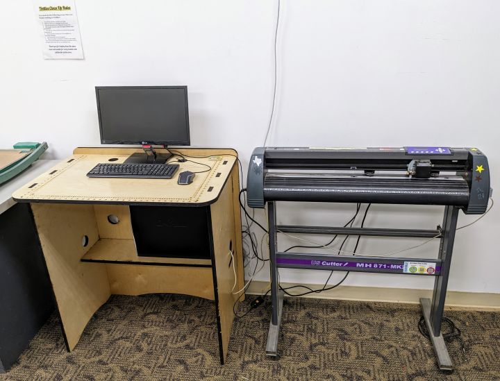

The USCutter MH871-MK2 is a 30" vinyl cutter.
