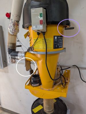

Filter Cleaning Steps
These are required after every use and should take no more than 30 seconds.
Filter Cleaning Video TODO Relocate video to proper in-house server.
  1. Power On the Machine
  2. Close Inlet Blast Gate (White Circle)
  3. Push down Pulse Bar (Black Circle) 5 times. Wait 2-3 seconds between pulses.
  4. Open the inlet blast gate
