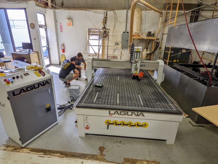

Laguna Swift Vacuum CNC
Asmbly recently acquired a Laguna Swift Vacuum CNC router. It uses the same software and workflow as the Laguna iQ CNC, but with a 5'x10' vacuum table work surface.
Cutting fluids are not permitted to be used on the woodshop CNC machines including the Laguna Swift and Laguna IQ CNCs.
Cutting of soft metals, such as aluminum and brass, is permitted on the Laguna Swift and Laguna IQ CNCs. Please be sure to clean the machine thoroughly to ensure all chips are cleared from the gantry and ways.
Hard metals like steel and cast iron are not permitted to be cut on the woodshop CNCs.
Members must complete the Intro to CNC Routers Class before using this tool
The Laguna Swift CNC has a 3hp continuous-duty liquid-cooled spindle and a 5' x 10' vacuum hold-down worktable.
It's equipped with a 4th-axis kit for turning workpieces up to 4" in diameter.

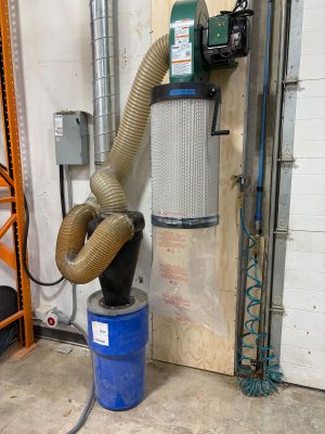

  7. Clean DC Filter. (Big CNC - Rotate the handle).

Filter Cleaning Steps
These are required after every use and should take no more than 10 seconds.
  • Rotate the handle on the filter.
  • Hear the flaps flapping
  • See the dust dropping
Grizzly 1.5HP G0944 Dust Collector
