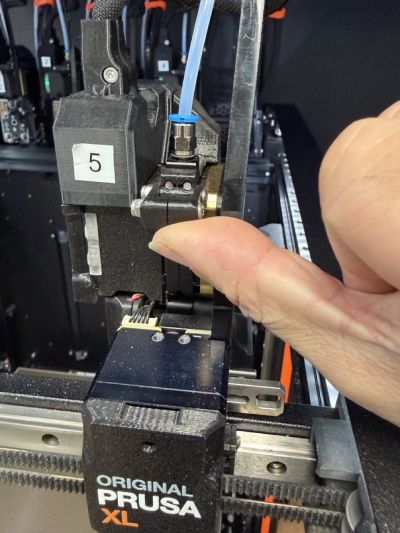

Trouble loading filament
If you are loading filament and it doesn't want to come out of the nozzle, here are some troubleshooting steps.

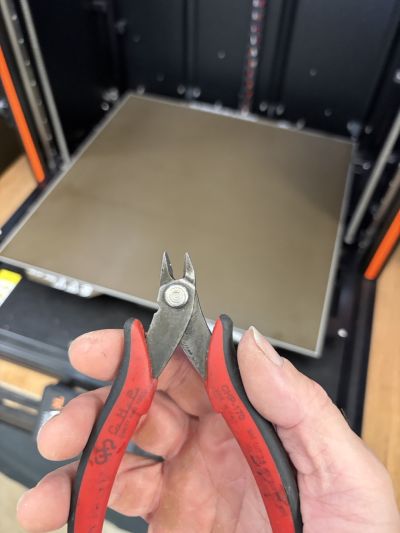

  1. Make sure you have cut the end of the filament at a 45° angle, use the diagonal cutters if not
  1. Check if your filament is loading into the tube that leads to the nozzle
    1. Lift the catch that holds the idler door
    1. Open the idler door
    2. Look at whether the filament is entering the tube
