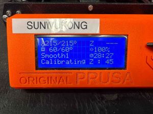

Make sure that your gcode is sliced for the particular kind of filament you're using. You can select the filament type on the control panel, and adjust the bed and nozzle temperatures.
Print Bed Sheet
🛑 DO NOT PRINT DIRECTLY ON THE BED. ALWAYS USE A STEEL SHEET.
The Prusa MK3S+ display showing that the Smooth1 sheet is active
Calibrated for Smooth1
Asmbly provides three different kinds of Prusa sheets:
There is a chart on the enclosure that lists which sheets are best for each kind of filament, or check Section 6.1 of the XL manual [2].
Ensure that the printer knows which sheet is on it. The sheets have different thicknesses, and you may not get a good first layer if the wrong sheet is selected.

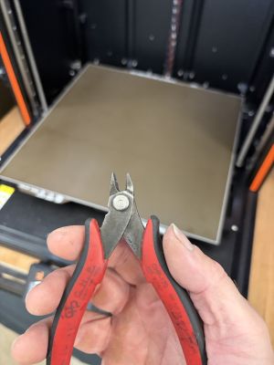

Make sure you have cut the end of the filament at a 45° angle, use the diagonal cutters if not

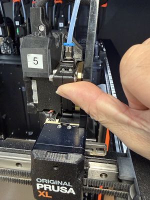

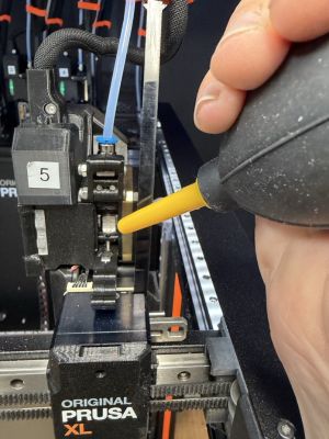

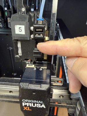

  • Lift the catch that holds the idler door
  • Open the idler door

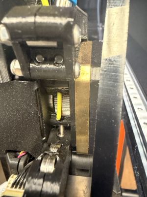

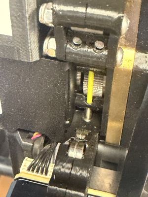

  • While you have the door open, look for any debris (usually ground up filament bits) on the idler gear. Use the air bulb (in the drawer of the wood table) to clean it out
  • Look at whether the filament is entering the tube at the bottom of the idler gear

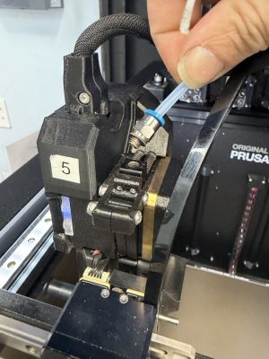

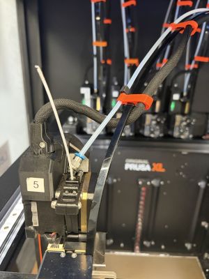

Filament missing tube Filament entering tube
  • If the filament is missing the tube, try grabbing the end with a pair of pliers and manually inserting it into the tube. Close the door and the catch and try loading again

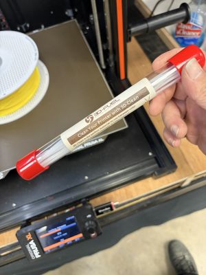

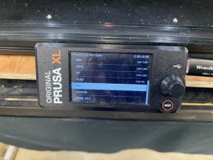

  • If the filament is aligned with with the tube, but nothing is coming out of the nozzle, probably some filament is stuck in the tube. Let's melt it out! Start by unloading your filament and then unscrew the end of the bowden tube.
  • Grab a piece of cleaner filament
  • Insert it into the extruder
  • Have the printer load filament at a temperature higher than what's in the tube. You can use a very high setting like PA if you don't know what the last filament was.
  • Hopefully, you should see something oozing out of the nozzle, and then eventually the translucent white of the cleaning filament. Use the "Purge More" command until the color is mostly translucent.
  • Unload the cleaning filament using the console and screw the bowden tube back in. Your filament should now load.
