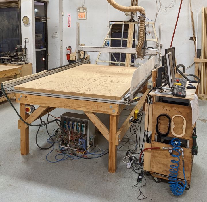

The Big CNC is a custom CNC router designed and built by Danny Miller. It has a maximum cutting area of 5' by 8'
Max Z height is approx 7.5" from nut to spoilboard, but this does vary as spoilboard is added or removed. Note that the max usable stock height will typically need room for your bit to go on top of it. e.g. a 6" block could potentially have a 1" pocket in it if a bit with a 1" cutting length is chucked. However, that block could not have a 2" pocket because the bit would need to have 2" cutting length sticking out of the nut which would be 8", not even counting the clearance needed to ensure the bit does not hit the stock when jogging across the top.
Spindle 3KW digitally-controlled VFD using an ER20 collet system. Manual bit changes, no ATC.
LinuxCNC control system
Z-height may be set by wireless toolsetter provided, or eyeballing it
CAM postprocessor should be "LinuxCNC", and not an ATC version. If nonarcs is an option, this is recommended over the arc option, but arcs will work. LinuxCNC used to be called "EMC2" long ago, "EMC2" postprocessors should work.
Cuts wood, plywood, plastic, many other materials. It is also capable of cutting nonferrous (aluminum, copper, brass) sheet metal and nonferrous billets (thick blocks of metal stock) with proper feedrates and compressed air nozzle. The compressed air nozzle will drive chips out of the cutting area so they are not re-cut by the bit and provide some cooling. For billets, while the CNC router may be capable of it, the Tormach is more capable as it is stiffer, lower RPM, and equipped with flood coolant.
CANNOT CUT STEEL. Steel requires coolant which is not compatible with the MDF bed. Steel can create red-hot chips and sparks which can start a dust collector fire, a very dangerous situation.
