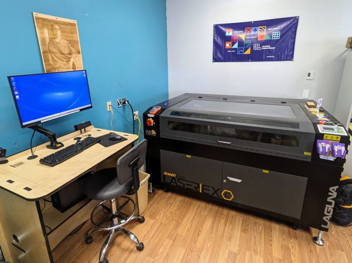

Dorian is a Laguna EX-C 150W CO2 laser cutter with a 36" × 51" bed. It uses Lightburn software with a Ruida controller — similar in operation to Tarkin. Dorian also has a rotary fixture for engraving round objects like glassware.

Location Laser room
