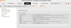

In PrusaSlicer, go to the Printers tab. Select Custom G-code. Scroll down to "Pause Print G-code" and paste the following:
G1 X0. Y210.           ; get the hotend out of the way
M104 S0                ; turn off extruder heater, so the nozzle doesn't dribble
M107                   ; turn off print fan
M300                   ; make a horrible noise to get the user's attention (optional)
M601                   ; tell printer to pause
@pause                 ; tell Octoprint to pause
M602                   ; resume
M109 S{temperature[0]} ; set extruder temp and wait for extruder to warm up
M106                   ; turn on print fan
M117 Resumed           ; write message on the screen
Now, when you This should work whether the job is started from Octoprint or from the SD card. You should be able to resume either from the control screen on the printer or from Octoprint.
You may be tempted to paste some or all of this using "Add Custom G-code". This will work fine, with one exception. "{temperature[0]}" will not be correctly expanded if it is not inserted by the slicer, you'll need to change that to an actual temperature, eg. 215 for PLA:
M109 S215              ; set extruder temp and wait for extruder to warm up
