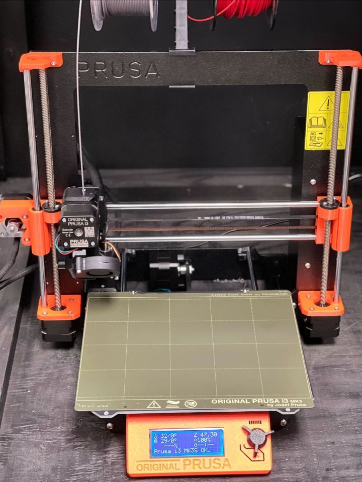

Asmbly has three Prusa i3 MK3S+ 3D Printers. In the Multi-Purpose Room, these are the three smaller machines in the large enclosure. The one on the left is named Apollo, and the middle is named Hermes, and the rightmost is Sunwukong.

The Prusa MK3S+ are good printers to produce small and medium sized objects using a single filament using many common filament types. The printer only uses one filament at a time, so if you want to print with multiple filaments, you will have to manually change filaments mid-print.
If you need to print larger things or to use multiple filaments without manually changing them, use the Prusa XL.
If you need to print in ABS, ASA, or other materials that print better enclosed, consider using the PolyPrinter 229.
