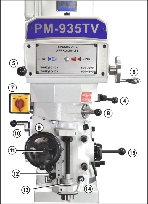

Controls
4 Back Gear Selector
5 Spindle Brake
6 Spindle Speed Control
7 Motor Switch
8 Quill Auto Feed On/Off
9 Quill Fine Feed Handwheel
10 Quill Auto Feed Rate Selector
11 Quill Auto Feed Direction Plunger
12 Quill Auto Feed Lever
13 Micrometer Depth Stop
14 Quill Lock
15 Quill Manual Feed Handle

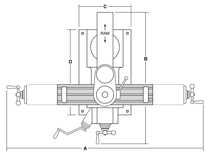

Specifications
Table Length 54"
Table Depth 10"
Overall Width (A) 107"
X axis travel 36"
Y axis travel 15"
Z axis (knee) travel 16.9"
Spindle nose to table surface (min) 2"
(max) 26"
Spindle centerline to Z ways (min) 5.5"
max 26"
Ram travel 20"
Quill travel 5"
Head Tilt Left/Right ±90º
Head Tilt Front/Back ("nod") ±45º
Turret Rotation 360º
approximate weight 3000lbs
