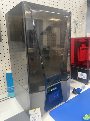

Tethys
Asmbly owns the ELEGOO Saturn 3 Ultra SLA printer.
Members must complete the Intro to Resin 3D Printing Class before using this tool
$ There is an extra charge to use this tool $
Photo of Elegoo Saturn Resin printer
Tethys (Elegoo Saturn 3 Ultra)
Manufacturer Elegoo
Model Elegoo Saturn 3 Ultra
LCD 10-inch 12K Mono LCD
System EL3D-4.0
Slicer Software CHITUBOX & Voxeldance Tango
Technology MSLA Stereolithography
