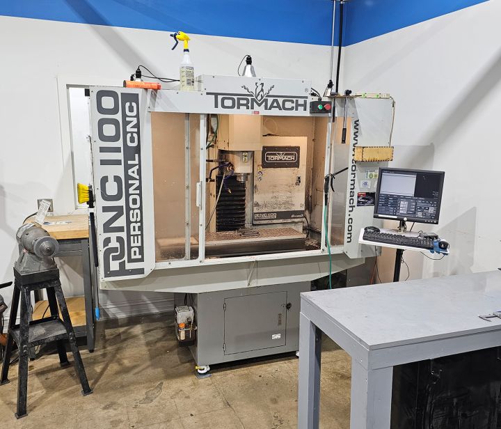

The Tormach PCNC 1100 is in an enclosure in the corner of the metal shop, to the right of the Rong Fu RF-45 Mill.
Tormach PCNC 1100 Series 3
  • 1.5hp R8 Spindle
  • Table Size: 34" x 9.5"
  • Table Slots: 3 Slots 5/8"
  • Travel: 18" x 9.5" x 16.25" (X,Y,Z)
  • Spindle Nose to Table: 17" maximum
  • Spindle Center to Column: 11"
  • Spindle Nose Diameter: 3 3/8"
  • Max Workpiece : 500 lbs Maximum
