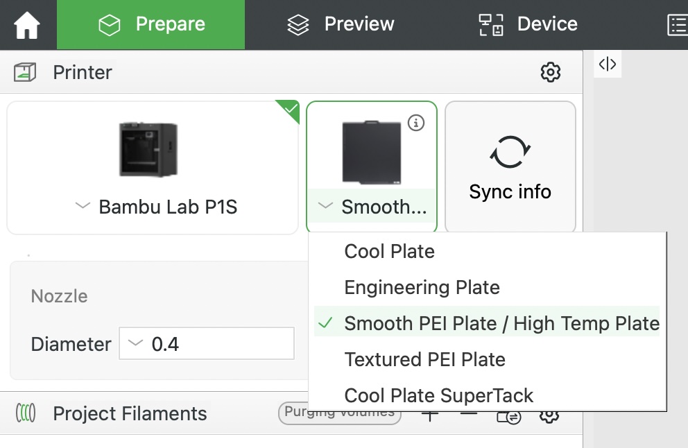

Print Bed Sheet
🛑 DO NOT PRINT DIRECTLY ON THE BED. ALWAYS USE A STEEL SHEET.
Make sure you set the sheet when preparing your print in BambuStudio.
