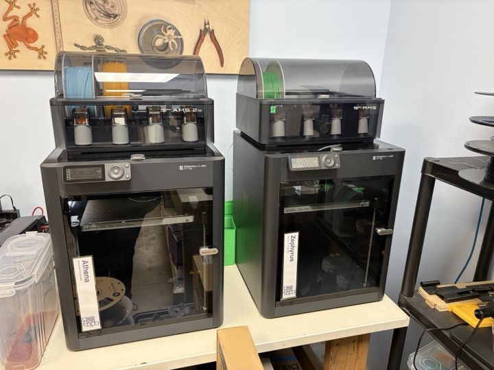

Asmbly has five Bambulab P1S 3D Printers and several Automatic Material System (AMS). Located along the west wall of the Multi-Purpose Room. The P1Ses is named Athena, Zephyrus, Bastet, Hanuman, and Chantico.
ASMBLY Bambulab P1S Printer
Athena
Status Active
Video Feed [TBD]
Manufacturer Bambulab
Model P1S + AMS
Nozzle Size 0.4mm
Nozzle Type Stainless Steel (Abrasives Not Allowed)
Nozzle Count 1
Filament Size 1.75mm
Print Volume 256 x 256 x 256mm
Max Bed Temperature 100C
Max Nozzle Temperature 300C
Max Print Speed 500mm/s
Extruder Type Direct
Manual [1]
Control Interface Unknown
Network Address TBD
Bastet
Status Active
Video Feed [TBD]
Model P1S + AMS
Nozzle Size 0.4mm
Nozzle Count 1
Manual [2]
Network Address TBD
Chantico
Status Active
Video Feed [TBD]
Model P1S
Nozzle Size 0.4mm
Nozzle Count 1
Manual [3]
Network Address TBD
Hanuman
Status Active
Video Feed [TBD]
Model P1S
Nozzle Size 0.4mm
Nozzle Count 1
Manual [4]
Network Address TBD
Zephyrus (Engineering Station)
Status Active
Video Feed [TBD]
Model P1S (Engineering modified)
Nozzle Size 0.4mm
Nozzle Type All-Metal Hardened Steel (Abrasives Permitted)
Nozzle Count 1
Manual [5]
Network Address 192.168.0.60

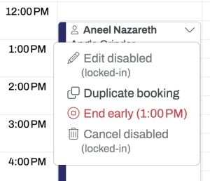

Booking Policies
Time booked for 3D printing in Skedda does not count against your weekly Asmbly hours. It is fine for a print to continue while Asmbly is closed.
  1. Book all of the time you need. Only print during time that you have booked. Don’t start prints that will go beyond your booked time. If your print has been paused or stopped because of a problem, don’t resume or restart it if it will go beyond your booked time. If time is available after your booked time, feel free to book more time to finish your print. If another member has already booked time that your print would need to use, and you contact them and get their approval, you may finish your print. However, if you do not manage to contact them, or if they do not agree to let you continue, then do not start, resume, or restart prints that would go into their time.
  2. Time you book is yours. If you arrive for your booked time and a print is ongoing, you may stop that print. If a print only has a few minutes remaining, it would be nice if you let it finish, but you are not under an obligation to do so.
  3. Give back time that you don’t need. If you realize you’ll be late, change your booking to start when you’ll actually be ready to start. If your print ends early, end your booking early in Skedda.
  4. Don’t let time go to waste. There is a two hour grace period at the beginning of a booking. If the booker is not present after two hours and the printer is still idle, another member may claim the remainder of the time on a first-come, first-served basis. Email [[6]] to let us know that this happened. There is a 30 minute grace period after the completion of a print. If the booker is not present and the printer is idle, another member may claim the remainder of the time on a first-come, first-served basis. Email [[7]] to let us know that this happened.

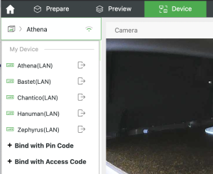

Setting up a Printer in BambuStudio
To print over Asmbly's wifi network, you will need to set up the printer in BambuStudio.
1. Navigate the the Device tab and click on the printer name, or "No Printer" if no printer is currently selected.
2. Select "+ Bind with Access Code" 3. You will be prompted for the IP Address and Access Code. On the Control Panel of the printer, navigate to the circle (gear???) icon. You should see WLAN and DEVICE submenus. The IP and Access Code are in the WLAN submenu. Please don't click the round arrow next to Access Code. You'll break everyone else's binding. 4. You will be prompted for the Serial Number and Model. The serial number is the "Printer" in the DEVICE submenu. It starts with "01P...". The Model is P1S.

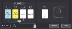

Filament
Make sure that your slicer settings take into account the particular kind of filament you are using.
The P1S + AMS supports 4 filaments in the AMS OR an external filament spool. Bastet has a spool holder on the side for an external filament spool.
On the Device tab, you can tell the printer which filament is loaded. Click the pencil and enter the information.
If you need help loading or unloading filament from the rear spool holder, please visit [10] or [11], respectively.
