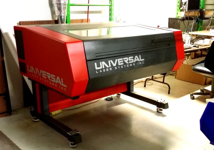

Our ULS-XL1200, colloquially known as "Big Red", has been retired after a long life of service to the space. Since this model was an evolutionary dead-end and service parts have largely become unobtainable, Asmbly's board decided to stop feeding the money pit after a tube fritzed out and the controller started going randomly woobly during rastering.

The Universal Laser Systems XL-12000 laser cutter is a powerful, industrial-grade laser engraving and cutting system engineered to handle advanced engraving, cutting, and marking applications. It features a 48" x 24" working area, 120 watt output CO2 laser, and air assist to keep both optics and cutting zone clean. The XL-12000 is driven by servo motors, making it faster than its less powerful cousins which are driven by stepper motors.
Some Specifications and Features of "Big Red"
  • Engineered to handle advanced laser engraving, cutting and marking needs
  • Front door and overlapping, wraparound top door with sloping front provide easy access for loading and unloading
  • Active matrix color screen on XL control panel displays preview of each job and allows user to recall and repeat any print job
  • 24" x 48" cutting area
  • 120 watt laser ( 2 beam combined 60 watt tubes )
  • Advanced beam indicator that precisely indentifies the point of laser impact
  • Built-in protection for optics from air compressor
  • Automatic detection of installed options
  • The honeycomb bed should be replaced with 24" x 48" and 1" thick aluminum honeycomb, 1/4# cells. The bed actually extends a bit beyond the 24" x 48" cutting area, so a slightly oversized piece of honeycomb is desirable.
