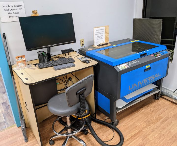

Blue is a Universal Laser Systems PLS 6.60 laser cutter — a 60W CO2 laser with a 32" × 18" bed capable of cutting, engraving, and marking a wide range of materials. It is driven via the ULS print driver from CorelDraw, Inkscape, Illustrator, or other vector applications installed on the laser room PC.
Specifications
Laser Type CO2
Power 60W
Bed Size 32" × 18"
Controller ULS (Universal Laser Systems)
Software ULS Print Driver (prints from CorelDraw, Inkscape, Illustrator, etc.)
Z Axis Adjustable (focus set via focus tool — do not use the white button or software Z)
Location Laser room

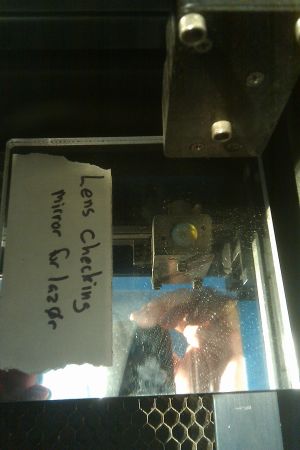

Dirty Optics
If the laser is cutting poorly, inspect the lens using the mirror and lamp kept on top of the machine. Carefully place the mirror onto the vector table underneath the cutting head and shine the lamp down onto it to illuminate the underside of the head:
When it's dirty, it looks dull and greyish-brown like this:
The lens should appear golden-yellow (the lens is coated with a thin layer of gold).
  • Do not operate the laser with dirty optics at high power — heat from the dirt can permanently ruin the gold coating or crack the lens.
  • Do not attempt to clean optics without specific training. The procedure is described in Cleaning the Laser Cutter, but should not be undertaken without hands-on instruction — the optics are fragile and easily damaged.
  • Fill out a problem report by scanning one of the red QR codes in the space — this notifies the space stewards. Do not use the machine until cleared by authorized personnel.
