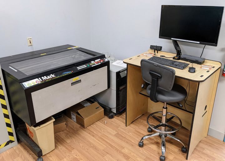

Pearl is a Royal Mark RSX-1832 laser cutter. It shares the same chassis as Blue (it even has ULS badges on the back) but runs at 100W — slightly more powerful than Blue — and a rotary fixture for engraving round objects like glassware.
Specifications
Laser Type CO2
Power 100W
Bed Size 32" × 18" (approximate)
Controller ULS-compatible
Software ULS Print Driver (prints from CorelDraw, Inkscape, Illustrator, etc.)
Z Axis Powered (manual focus adjustment via stick)
Air Assist Yes (not functional as of October 2021 — check current status)
Rotary Fixture Yes
Location Laser room

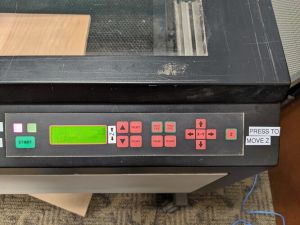

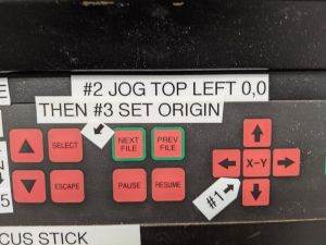

  1. Press the X-Y button to enter jog mode.

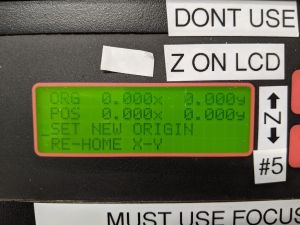

  2. Use the arrow keys to jog to the top-left of the bed. The LCD should read POS 0.000x 0.000y on the second line.
  3. The cursor should be on SET NEW ORIGIN — press SELECT, confirm the prompt. The display should now also show ORG 0x 0y on the first line.
The LCD should read ORG 0x 0y on the first line and POS 0.000x 0.000y on the second:

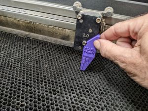

Updated Focus Tool
There is a newer 3D-printed focus tool that form-fits the carriage front — clearer to use than the original stick. This is also the correct tool for rotary use, as the foot aligns inline with the laser focal point and the top of the work on the rotary chuck.
Updated 3D-printed focus tool

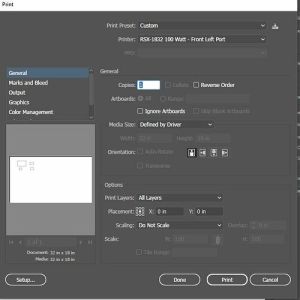

For Illustrator users:
  • Change stroke units to inches: Edit → Preferences → Units → Stroke = Inches
  • Set all vector lines to 0.001" stroke width (hairline). Thicker lines are interpreted as raster.
  • Print settings: Media size = DEFINED BY DRIVER; Orientation = PORTRAIT (Illustrator may reset this to Landscape when you visit Setup — recheck each time); Placement = CENTER, X=0, Y=0; Scaling = DO NOT SCALE.
  • Verify in Preview before sending.
Illustrator print settings example

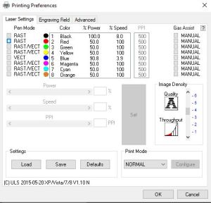

In the ULS Setup window, set speed, power, PPI, and rastering settings.
ULS print driver settings — note there is no Z entry (Pearl runs wherever you left it after the stick)
Pearl does not have a Z setting in the driver (unlike Red/Blue) — it runs wherever the Z was left after your manual focus adjustment.
